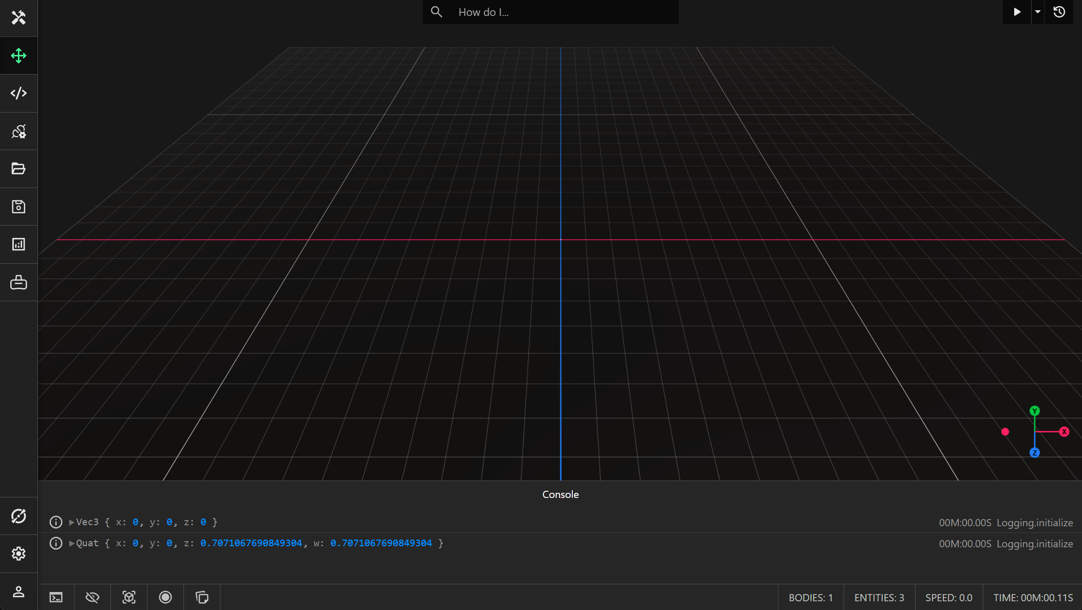

You can drag the top of the window to expand the developer console. This will consequently make the height of the viewport smaller. You can also log objects to the console:
console.log(this.entity.position); // Vec3 class
console.log(this.entity.rotation); // Quat class
Console Objects
