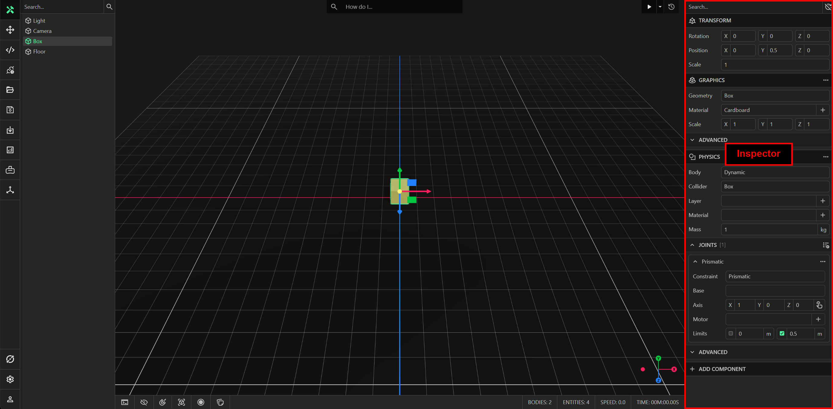

The inspector lists components added to the currently selected entity. It can be used to add, modify and remove components on the selected entity. You can only do this to one selected entity at a time.
Inspector
Adding Components
To add components to an entity, you must first select the entity to which you want to add components. The inspector lists all components currently added to the selected entity. Click the Add Component button, then select the component type you wish to add to that entity. The added component will then be displayed in the inspector. The dropdown menu will list the built-in components (such as the physics component, motor component, etc.), including any scripted components that you created. The Add Component dropdown menu also includes a search bar, allowing you to search for the component you want to add.
