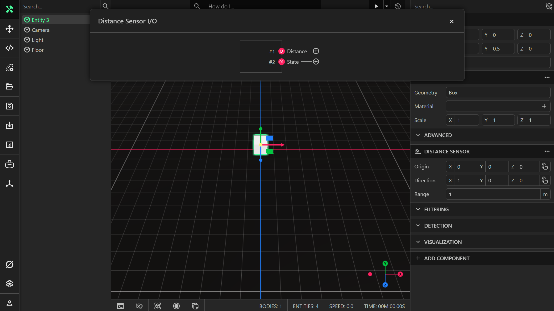

The IO signals for the distance sensor component. Please see the DistanceSensorIO API documentation for more details.
Distance Sensor IO
Distance
A double readable (output) signal that stores the measured distance. The value will be 0 if the distance sensor does not detect an entity.
State
A boolean readable (output) signal that has the value true if the distance sensor detects an entity, and false if the distance sensor does not detect an entity.
